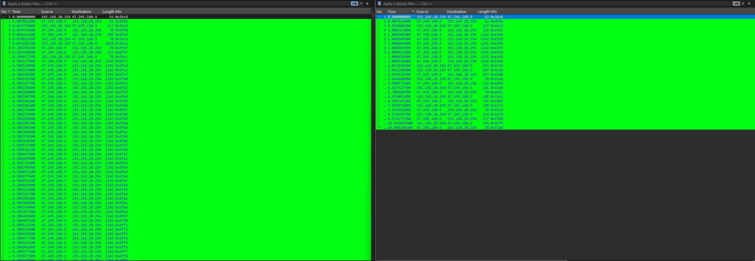

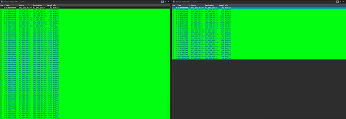

I try to migrate from wireshark-on-device to sniff-on-router for an application, the only thing I can provide, is this screenshot:
The left side: wireshark
The right side: TZSP.exe > the pcap file
ip.flags.df eq false does reduce the amount of packets on both sides, but there are some left.
The info shows the packet ids: as it can be seen, the first couple of packets have the right ids, then skipping happens, which reports completely different ones. Scrolling up to the end, I can see 0xf7a8 in some of the last packets on the left side. So no packet manipulation of any form happens between the capture on device and the router's sniffing.
