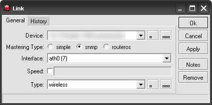

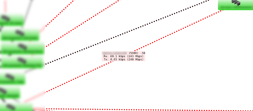

I’m using The Dude v4.0b2 and I have several Ubiquiti wireless devices (Rocket M5, NanoBridge M5, NanoStation M5) that are being monitored utilizing SNMP. The dude (same version) used to have black links and change them to red as the load got heavier on the link but now they’re just solid red. I am not 100% positive about this but there is a good chance that the problem arose from upgrading the firmware on the devices to v5.2.1. I checked out the changelog for the firmware which states the following as one of the fixes:

I have attached images of the link, the link properties, and the link type properties:

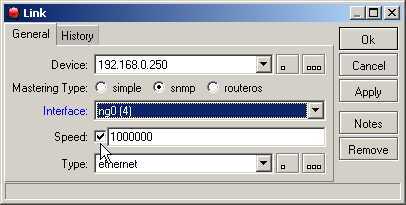

I would try checking the speed check box and setting the speed to the actual speed of the link. i.e. 200M link = 200000000 I had to do this for several of my licensed microwave backhaul links. The only issue i run into is that with adaptive modulation you do not see this reflected during bad weather or such when the link is degraded and you pipe is less than it’s rated for.
Thanks for the suggestion. That does work as a workaround for the moment so I’m not seeing all red links. Still curious as to the specifics of how the link rate is probed without manually setting it if anyone else has any insight that would be appreciated.

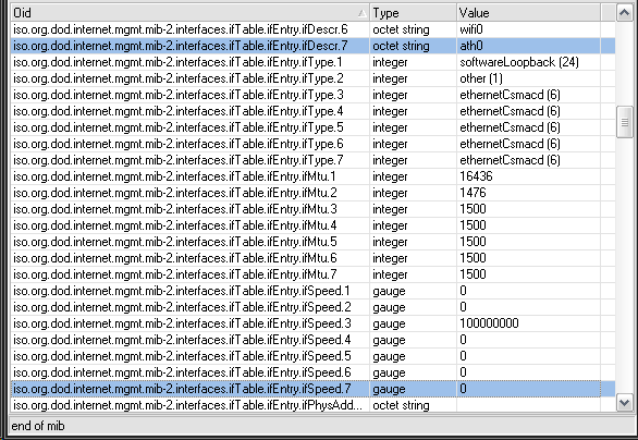

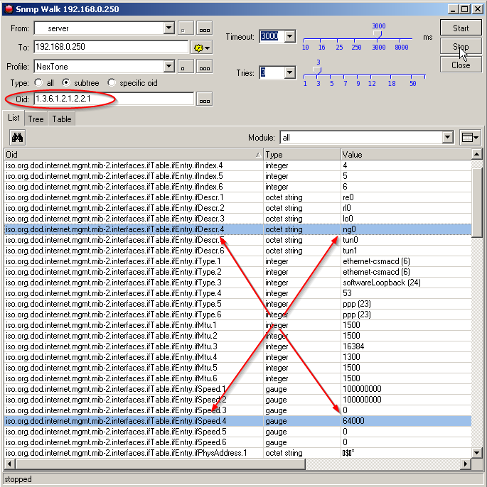

If you do not set your link speed manualy
Liks speed is taked by The Dude from SNMP ifSpeed

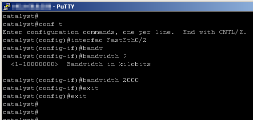

Setting ifSpeed is specific for OS, for example to set speed on Cisco switch on interface Fe0/2 to 2Mbit you should use commands
Ah-Hah!
That’s exactly the info I was looking for! I went ahead and did an SNMP walk on one of my bridges and sure enough the link speed is reporting as 0. I’ll post this info over on the UBNT forums and see what they have to say. Thanks for your help!
The only one that seems to be reporting properly is the ethernet port which is interface 3 according to the walk.

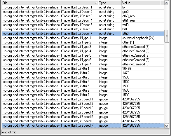

Downgraded to firmware 5.2 on the device and the interfaces now show a nonzero, albeit incorrect value for all the interfaces.
