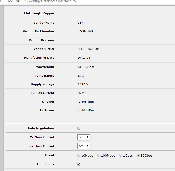

Replying to my own thread… seems the answer is ‘yes’ they do work, in my scenario at least. I’m going from a CCR1009 to a CRS226.
Strange though that the CCR does not show the SFP information (vendor, serial, etc) and does not give options to advertise 10G speed even though it says it is linked at 10G.
The CRS226 does, however:
Just updated the CCR to the latest ROS in case that solved it but no change. Any staff member care to comment on why this is?
Chris
