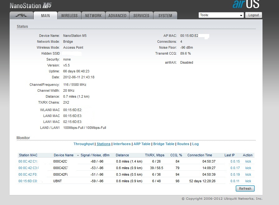

On the pictures I want to show how the connection holds UBNT far better than Mikrotik.

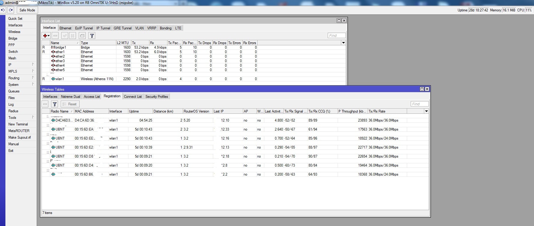

AP Mikrotik and UBNT several clients and one mikrotik.
UBNT AP and several clients Mikrotik and UBNT one.
UBNT always keeping a link a few days, mikrotik just a few hours!

I also have many mikrotik only AP and clients. Here I wanted to demonstrate the difference between Mikrotik and UBNT already in common 802.11.

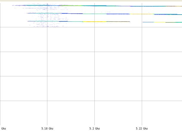

It is true that all are in noisy environments. But UBNT holds several days. Mikrotik only a few hours, sometimes just minutes. And also talking about NV2 and AIRMAX.
Otherwise, I have a network of only 90 percent mikrotik. And unfortunately I was very disappointed NV2, moving constantly in noisy environments.
