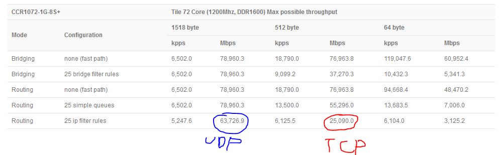

For the CCR1072 I tested, I found out the figures are quite accurate (always divided by 72 for single core, which I learned):
Both, TCP and UDP, tests are carried out with 1500 byte packets.
