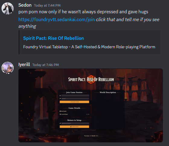

So I did a fundamental setup to check if I could get port forwarding working. So, yes I did use the router quick start which from reading is rather advised against but at least it gives me a basic config to start with so it did its job. So I setup a hairpin nat which works just fine TCP port forwarding is working then I went to test UDP and nothing. This was done by having a friend try to connect to Teamspeak using port 9877. He is unable to connect so double-checked and had him connect to my web server which host foundry he can see just fine.
This was the TCP test had to ask my friend to check it via discord.
