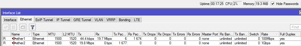

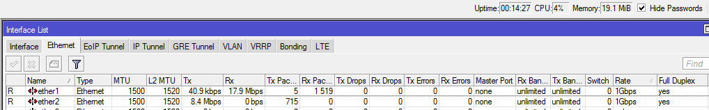

It seems like there is a problem when streaming PC is connected on 1 Gbps - only half of packets are forwarded on RB750G. It is working fine when the speed is 100 Mbps - see the screenshots. Any ideas? Strange thing is that TCP is working without any problems - I’ve measured over 920 Mbps routing speed between IP segments through RB2011L. My network card is Realtek RTL8111E.

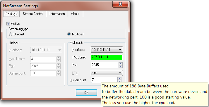

In DVBViewer there is a parameter “buffercount” and I had there a value of 100 and it makes troubles with connection tracking as I have described (half of datagrams were lost on RB750G). I was doing some experiments and it seems that values between 5 and 10 works best for RB750G, but it is not as good as VLC streaming.
