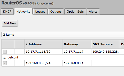

Probably you have default config and at ether1 exist dhcp-server who should be disable to not provide you a old address..
Ok thanks for the reply. So I must disable DHCP as well as activate IP Passthrough. I thought that by activating IP Passthrough DHCP would be automatically disabled as it is no longer required and no longer relevant on the UHG side. It really should do this automatically as there is no need for it to be active.
Thanks again for the info. I will try disabling it tomorrow and see if that fixes the issue.
Ok switching off DHCP has indeed fixed the problem. So to summarise for anyone else having difficulty here’s a quick guide to setting IP Passthrough via WebFig:

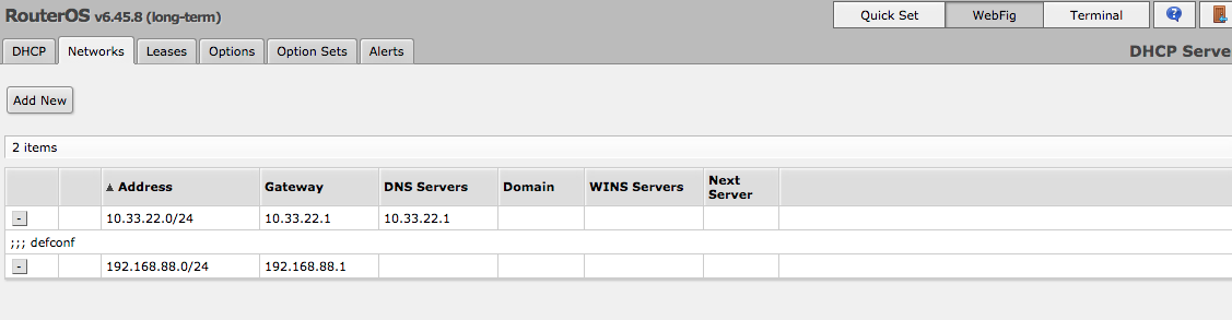

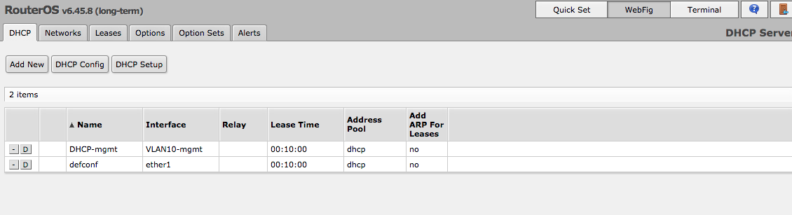

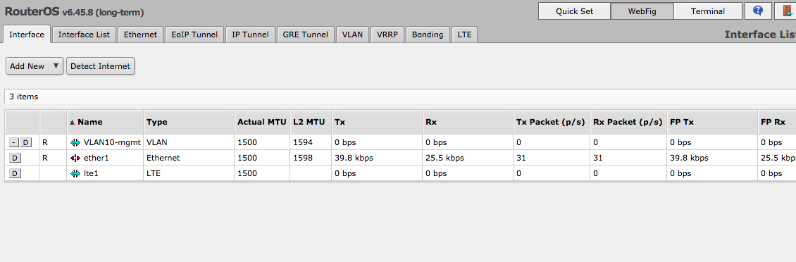

I’ve put my UHG in safe mode and had a go at configuring a VLAN for management but before I commit to actioning it, could you look at my setup below and advise what I’ve missed? I’ve just setup one VLAN for management and will put the LTE APN in passthrough. I’ve set up DHCP on the mgmt VLAN but no doubt I’ve missed something. I’m thinking the gateway is wrong on the mgmt DHCP? Should this be 192.168.88.1??

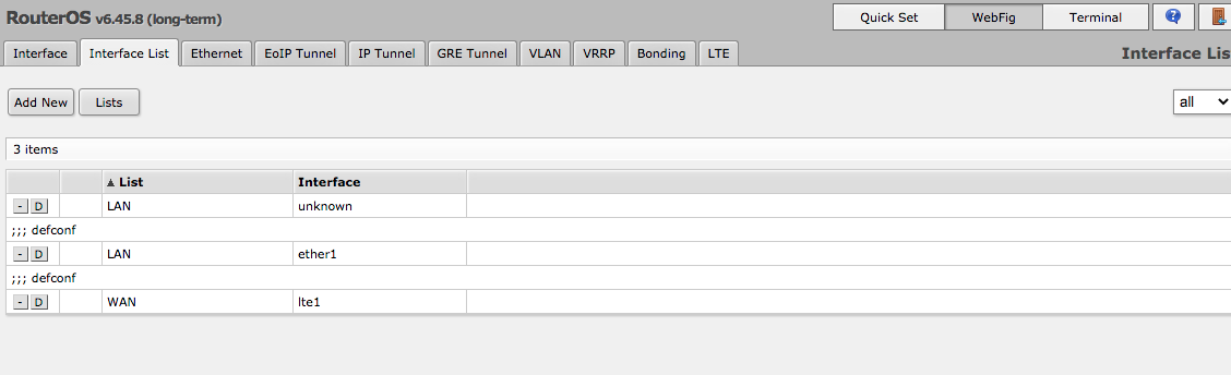

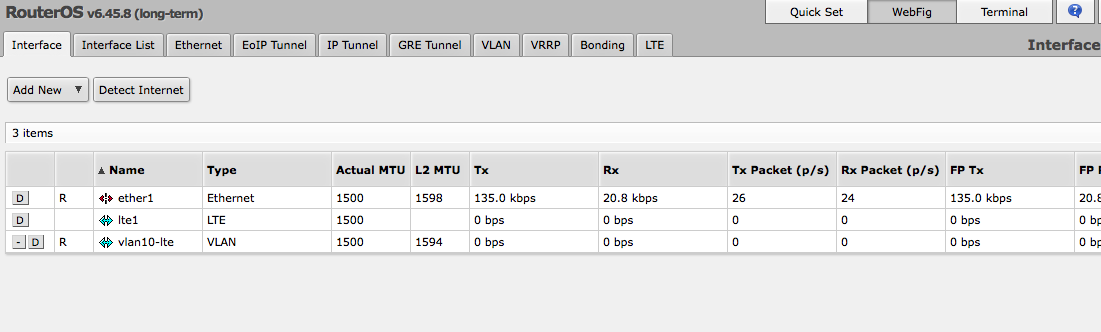

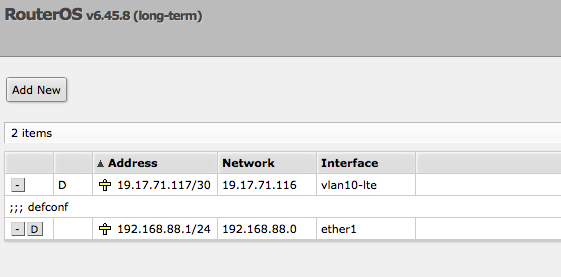

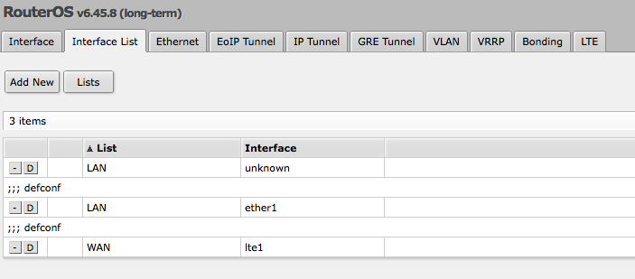

After reading various threads on IP Passthrough and management on a LHG, I’ve tried to set mine up matching what was discussed. The advice seems to be to use IP Passthrough on the VLAN interface and management on the ether naked interface. Here’s screenshots of my setup. I am successfully showing a WAN IP address through the LTE interface but when I connect the UHG to another routers WAN interface it’s being assigned a LAN IP (192.168.88.xx) rather than the WAN IP. So why isn’t the WAN IP being passed through to the router WAN port??
I created a VLAN with an ID of 10 and have used this as the passthrough interface on the LTE APN settings. Under the Interface List I’ve tried changing the interface for the WAN from lte1 to vlan10-lte but still no WAN IP being passed through to the router. Have tried also connecting laptop direct to the UHG but again it’s getting a LAN IP from the UHG and not the WAN IP.
Really appreciate some pointers as to what I need to change to make this work.
