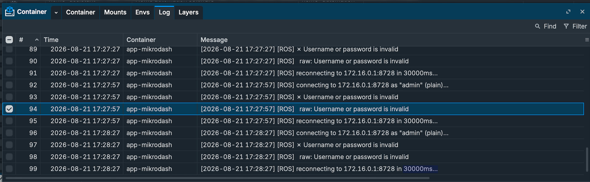

I'm facing error told username or password is invalid when install using mikrotik apps... how can i fixed this ?

Are you able to launch the web gui? It should run the onboarding at first run to create the admin account.

Thanks! I found an error though. on the parameters it's impossible to change user/pwd of the user that makes api connection, but since yaml cannot be changed, you must use admin password atm. I suggest you to publish an update for this:
environment:
  ROUTER_HOST: "\[routerIP\]"
  ROUTER_USER: admin
  ROUTER_PASS:
I publish here the error because it's related to the app, not the docker itself!
