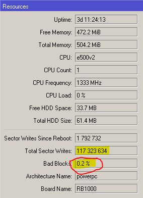

117 million sectorwrites and 0.2% bad blocks in about 5 weeks. So 3 million sector writes a day are too much and I had to stop using User Manager on an CF Drive.
Is there no way to reduce the sector writes?
