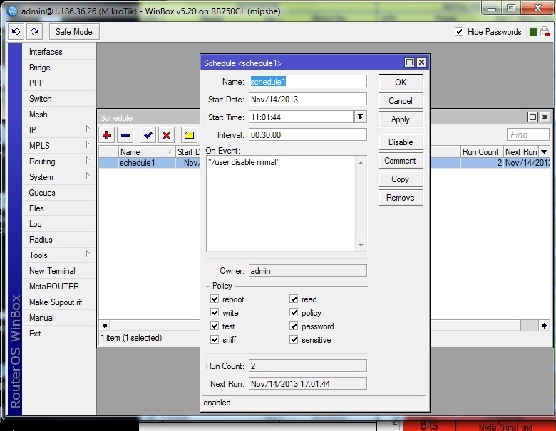

Kindly check the attachment, Is that right? Kindly explain about “interval” & “Run Count”
That looks good except that you will not need the quotation marks. The interval is in the format hh:mm:ss and it how often after the start time to run. The run count is how many time its executed that scheduler script.

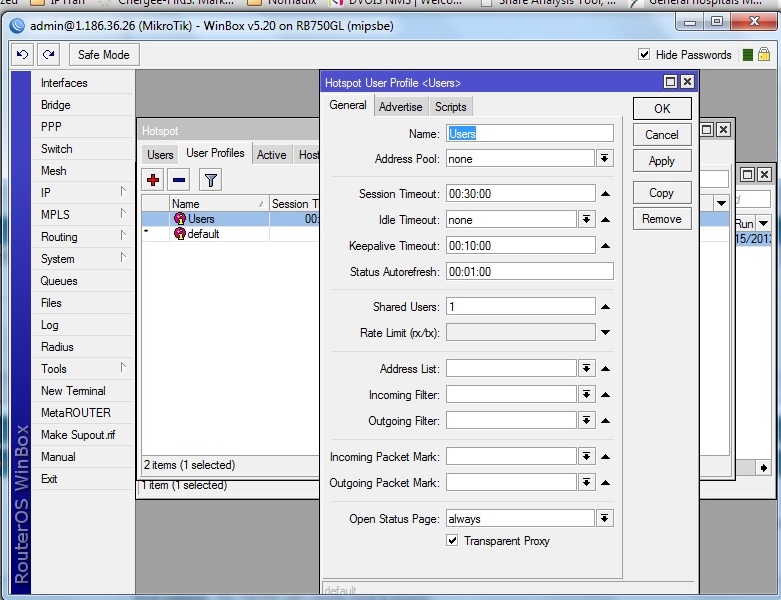

Still I have not fulfilled with My requirement,here with I attached the user profile- in this user profile I have created the one UN/Pw(nirmal/nirmal) so per the profile it getting logging in & disconnect in the correct 30 Min, but my requirement is it shouldn’t login after the 30 min end, it should say something like already used like that!!! but no after getting end the 30 Min, it try the login again it’s getting logging in.

Here with I attached the User Profile, In this profile I have created the Un/PW(nirmal/nirmal) Whenever I am logging in with this, Exact 30 Min it’s getting disconnect because the session time out kept only 30 min for this profile, after If again I tried for Loging in it’s getting logging in which i dont want want, my requirement is If it’s logged in one time it should disconnected in the session time which was mentioned & then it should not be able to login.
How to do that?
Oh, I’m sorry. I missed what you were trying to do all together. Why don’t you try User Manager? If that is an option for you, then it will solve the problem. Check out:
http://wiki.mikrotik.com/wiki/Manual:User_Manager

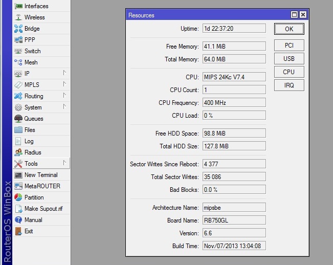

Will the below details Router will support User Manager config?
Yes, I have used User Manager on several RB-750s. Depending on how much use the router has, you may slow it down a bit. If the number of users is relativity small, it will be just fine.
