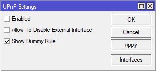

  • I’m confused by “(5) Why is upnp enabled? Normally recommended to keep this disabled.” The attached screenshot of my upnp shows it’s disabled though I do see this in my export
/ip upnp interfaces
add interface=bridge type=internal
add interface=ether1 type=external

/ip upnp interfaces
not mean than upnp is enabled, just some (unused) settings are still stored inside the config.
only that lines, NOT PRESENTS on your export, mean than upnp is enabled
/ip upnp
set enabled=yes
