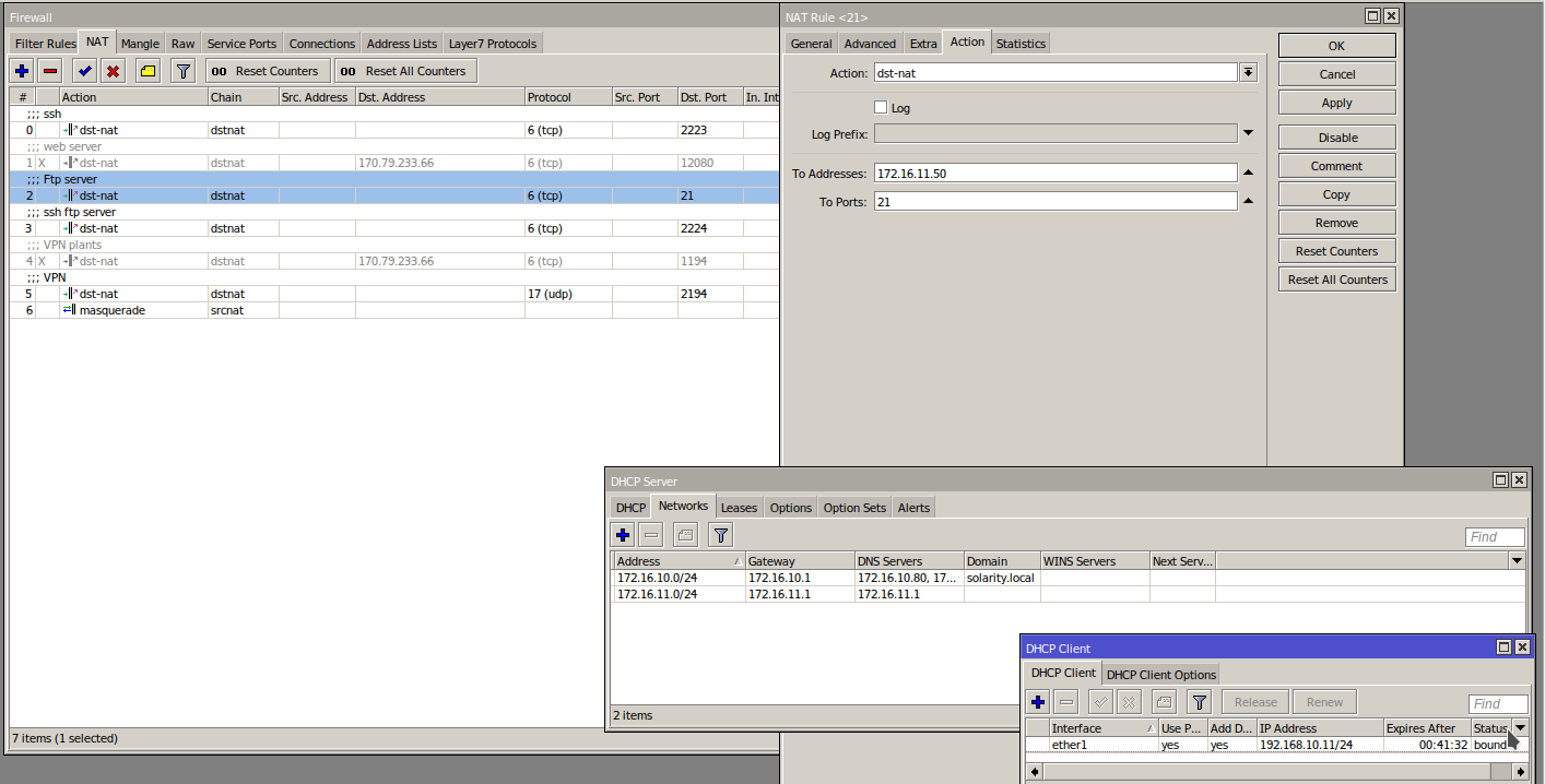

I found that if I disable the NAT rule which sends port 21 to my FTP server I’m able to contact the WAN FTP without problem. What I am missing here???!!

I think its because the MT sees the external WANIP request coming from the outside(tplink) and routes the traffic back as appropriate for dstnat.
Whereas the MT request to the WANIP is internal and will not work due to this diagram.
See diagram Number 3…
https://help.mikrotik.com/docs/pages/viewpage.action?pageId=3211299
So you need to config hairpin NAT or loopback.
How check out this thread…
http://forum.mikrotik.com/t/port-forwarding-nat/140845/2
In your case, you only need to add the masquerade rule in the above thread as the dst-address=fixedwanipofthemikrotik
