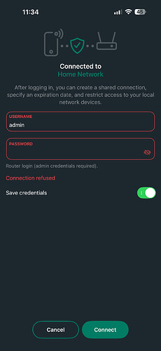

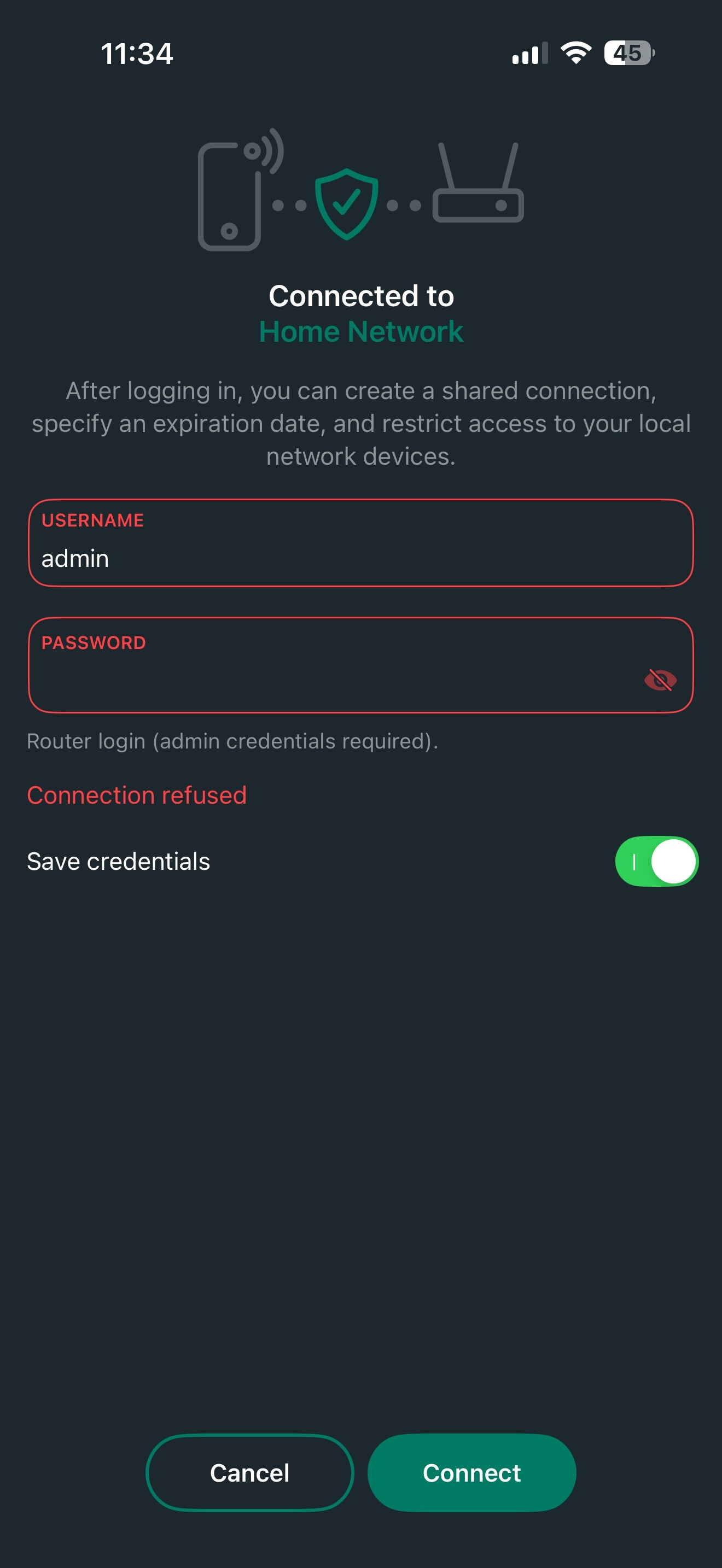

I have a CCR2004-16G-2S+ that I am using as my main router at home and I am wanting to add my tablet to the BTH VPN I have already set up. The device I set it up on is an iPhone 16 Pro Max, and I get to the step of authenticating with the router to add the necessary configuration to add my tablet to the VPN, but I always get a “connection refused” error (attached screenshot - I do have a password for the admin user). I have verified my username and password are correct and I am connected to my home network that the CCR2004 is, I noticed that the log also shows: “denied winbox/dude connect from 192.168.216.3” when trying to authenticate at this step on the app, and I also tried to add a firewall rule to explicitly allow Winbox access for this IP which didn’t help (I tested with the rule at the very top of the list and that made no difference). While the rule does fire, it still gives me the same error in the app and the same log message.
I have also attached my sanitised config in case there is a firewall rule or some sort of bad configuration which could be causing this to happen, I am still rather new to MikroTik and learning as I go so it’s very possible that I did something incorrectly when configuring my router.
All help is appreciated, thank you :slight_smile:

You are correct it absolutely refuses to let me connect via the BTH app to MANAGE shares, it refuses the connection outright. To be clear the BTH interface is on my trusted interface list and the subnet is added to the admin firewall address list. Both are required to access the router in input chain and all vlans, and thus why I can reach the router via the MT app or my capac etc… I also have no problems accessing the internet or other devices (switches tp link) through the iphone when connected via the BTH app as a user.
This leads me to think we can only add devices when connected via WIFI, the opposite of my initial thinking so will try that next.
No luck, unable to add users from my iphone, connection refused for managing shares if connected via wifi or via cellular to the router.
Sent a bug report and supout to MT.
Great, thank you for testing it, I’m glad to know that it’s reproducible by others and isn’t just bad configuration on my end :slight_smile: keep me updated with the results of the bug report to MT, hopefully it’s something they can reproduce too. BTH is such a nice feature and it’d be great to be able to add more of my devices to it.
I did notice that when trying to access through cellular, I get an “Unable to establish secure connection” message in the BTH app instead but the log on the router still says the same “denied winbox/dude connect” message, even though like you, I am able to connect via the BTH app to the tunnel and connect to the router through the MT app using the same credentials for the BTH user adding process so I know it can’t be that.

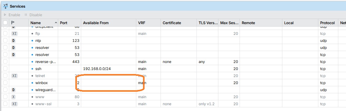

I got a response from MikroTik suggesting to add that device’s subnet to IP > Services > Winbox since it wasn’t there before, so I added 192.168.216.0/24 and that fixed it, now the BTH app fully works as expected :slight_smile:
Can you please describe how exactly you do that? I see no + button in winbox, and doubting to modify the one with VRF main in it.
I just went to IP > Services > double clicked the Winbox entry, and next to Available From I clicked the down arrow to add a new entry and added my phone’s subnet. It should look like this when done:

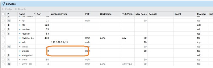

Not sure what the problem is but its certainly not the lack of entries in that table entry “allowed” –> here is mine and I access my router with winbox without issue.

Something wrong with your setup if you cannot connect to the router if the “available from” entry box is empty. This means there are no limits by Ip services for entry to winbox. I am stating this is a different issue and not related to BTH.
That’s very true, I did actually remove the entries in winbox’s subnets entry of Services and could still access my router without any problem. I’m wondering whether my phone’s IP changes or something when it’s on the VPN and that’s what causes the 216 address, because when my phone is connected normally to my network, I get an IP of 192.168.88.240 (although I can’t find that 216 address in the phone’s WiFi settings when the VPN is connected).
