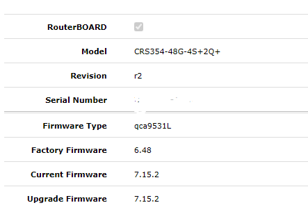

I am experiencing an issue with my MikroTik CRS354-48G-4S+2Q+ switch and am seeking some help. I’m unable to boot into SwitchOS. I will provide all the information needed to solve this issue.
Problem:
I am unable to boot into SwitchOS. Every time I try to boot into SwitchOS, I receive an error indicating that the kernel cannot be loaded. The device remains stuck in RouterOS.
Device Details:
Model: CRS354-48G-4S+2Q+
Current Firmware Version: RouterOS 7.15.2
RouterBoot Version: 7.15.2
Factory Firmware Version: RouterOS NOT 7.15.2
Factory Firmware RouterBoot: 6.48
SwitchOS Version: 2.16 (uploaded)
See Image 1 (System:RouterBOARD)

  • I have three other switches of the same model (CRS354-48G-4S+2Q+), and they all boot into SwitchOS and RouterOS without any issues. They are Revision 3, not Revision 2 like the problematic one.
