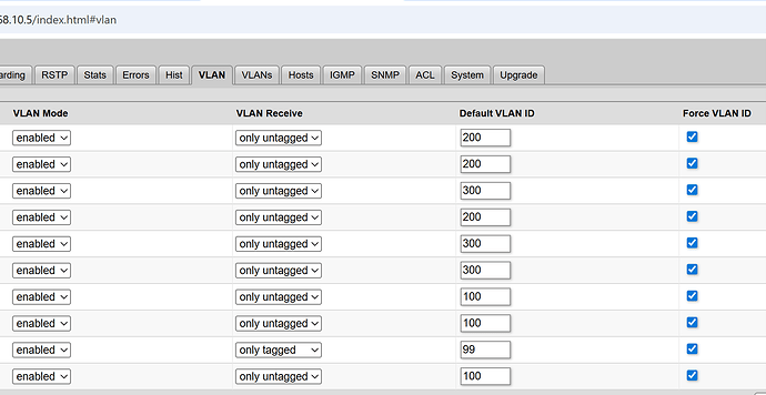

The issue: I’m having trouble setting up the trunk link between the vlan'd l2 managed switch and the openwrt (router on a stick) I have tried a few different ways of setting up subinterfaces and devices with the below vlan id’s but im unable to get the trunk link working in openwrt.

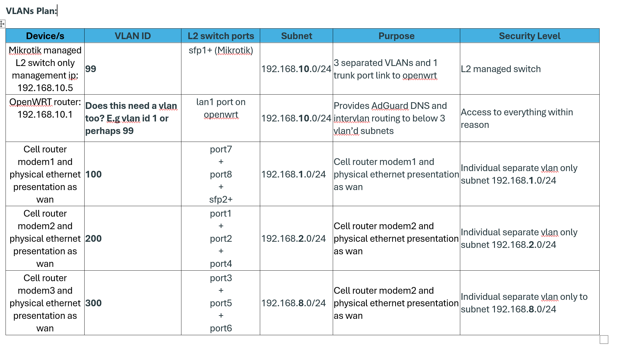

Also does the openwrt 192.168.10.1 need a vlan itself too? or perhaps open should be on different subnet to l2 switch? Am missing any config?

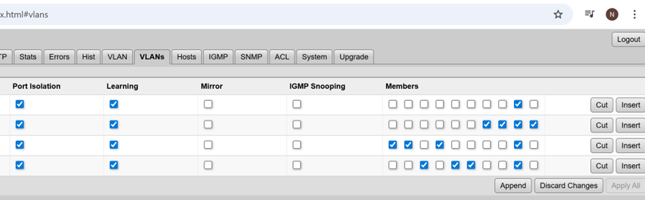

Included are screenshot of l2 switch vlan and vlans pages, also my vlan plan
Turn off Force VLAN ID, let the Membership and VLAN Receive settings do their thing.
You can’t use the same subnet for the switch management and the router on different networks / VLANs, a diagram of what you are attempting would help.

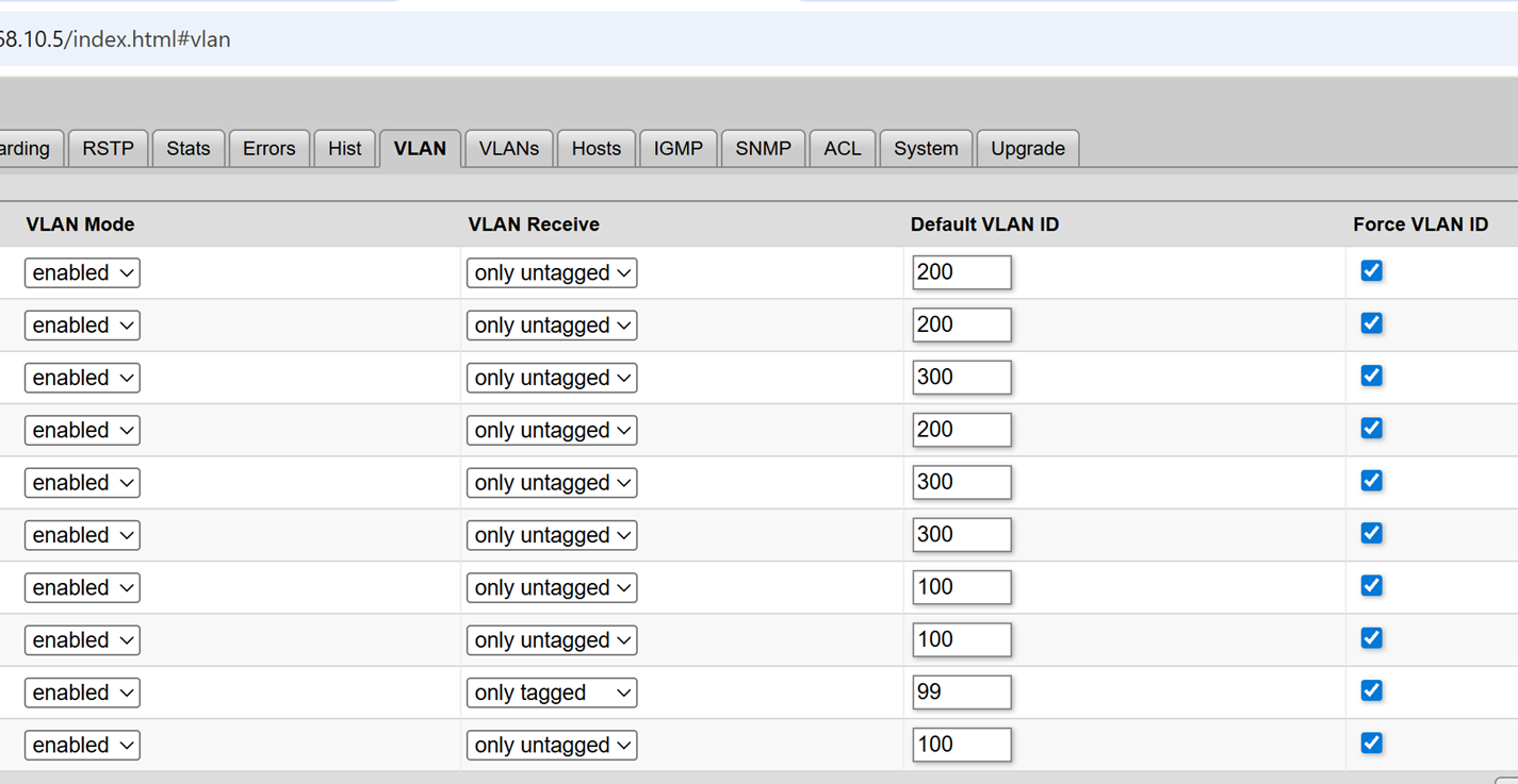

i’ve turned off force vlan id on all ports on l2 mikrotik switch, and changed mgmt ip of l2 mikrotik switch to 192.168.20.5 so switch and router are now on different subnets. In openwrt i’ve created subinterfaces for each vlad id - no joy

It could be the default VLAN ID on the Mikrotik switch trunk port as the documentation is unclear if it still untags matching VLAN IDs on egress when VLAN receive is set to Only tagged - try setting it to anything other than the IDs you are actively using.
