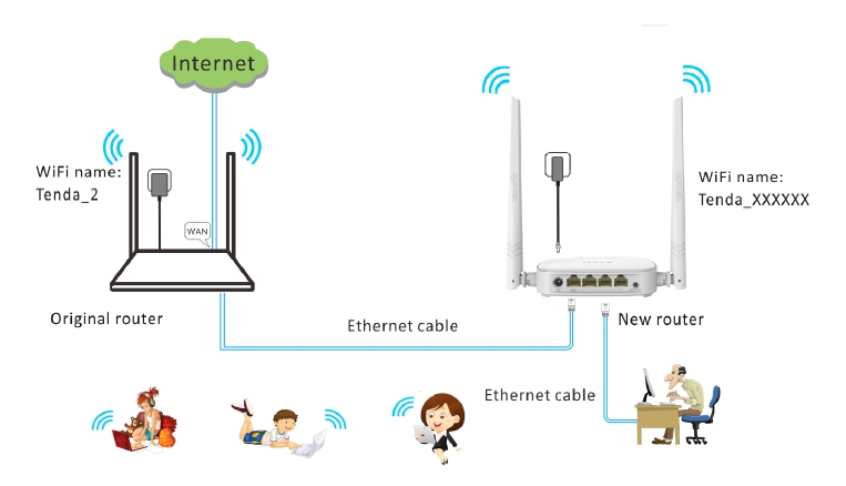

I want to configure my Mikrotik SXT Lite5 with Tenda(N301) for sharing the internet. I have a wireless PPPoE internet connection and when I directly plug the antenna cable to my pc, I am able to connect to the internet by putting the user id and password provided by my ISP.
But when I try to share the internet through Tenda(N301) router I was not able to connect to the internet. I have tried all possible configuration but I fail to establish the connection.
The connection I was trying to configure is
ISP → Mikrotik SXT Lite5 → Tenda(N301) → PC
Any help or guidance will be much appreciated.

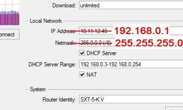

Ok I have made some changes to Mikrotik SXT. Previously it was configured in bridge mode. Now I have made some changes somehow I configured it in router mode now my Mikrotik SXT got the internet. I ping it to 8.8.8.8 and I am getting the response but there is no internet on the pc nor I was able to configure it with the Tenda (N301) router. I am sharing the screenshots of what i have done so far. I would request the forum members to go through the configurations.
Router Mode Configuration
Ping to 8.8.8.8
Local network IP address and DHCP pool (DHCP server range) does not match
(10.0.0.0 versus 192.168.0.0)
Your PC will have the wrong IP address if DHCP was used.

Ok, I got it but how to do it can you elaborate it in detail. When I open my Winbox I noticed that It was configured in bridge mode. Just with IP 10.11.12.40. These settings were all done by my ISP.
When your SXT is in router mode, that IP address can only be on your WLAN1 interface, not on the bridge.
Your bridge will have address 192.168.0.1 and you fill that in in the “local network - IP address” , with netmask 255.255.255.0 (/24) , in your CPE quicksetup. There should be no 10.11.12.40 in the local network, this is for the ISP side only.
You will lose the connection while changing , connect with MAC, or later connect to 192.168.0.1 from the LAN (Tenda wifi or ethernet ports Tenda or SXT)
