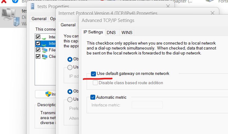

Perhaps someone has a good idea why it is not possible connect to local LAN devices with mikrotik ipsec+L2tp if I remove the option “Use default gateway” on a Windows computer? If this option is used, you can connect and everything works. Maybe I specified something wrong?

thanks for the reply!
=‘’ That leads us to know that if the far end network works at all it either has a different gateway or a different IP range.
Either way obviously you wont be able to connect to devices in that network unless you told windows when it connects to use the remote gateway..‘’=
if I use a range of IP addresses in the vpn configuration that are the same in the same subnet, then by turning on Proxy-arp I can establish a connection both using “use default GW” and without it. Everything works.
This problem occurred precisely when different IP address ranges are used in the vpn configuration.
If I create a vpn connection with two different subnets, then I must specify ‘‘use default GW’’ ? I also tried Bridge mode for these two subnets, but to no avail.
‘’= Fixing it may be as simple as a static route but no idea what that needs to be because we don’t know enough about remote network.‘’=
The remote network is a public dynamic ip address.
After reading the recommendations of forum members to use different subnets of IP addresses for vpn L2tp connections, I have created a remote vnp ipsec l2tp connection for several office workers.
Everything works correctly, but there are several problems with the fact that the Home connection speeds of the employees are quite slow in some places. And so there is a need to remove the “use default GW” option for the Windows vpn connection so that all Internet traffic does not load a slow Internet connection. Except for this option, the remote connection works much faster and more stable.
What exactly is good practice? Use different ip subnets for VPN connections or still use the same ip subnet?
