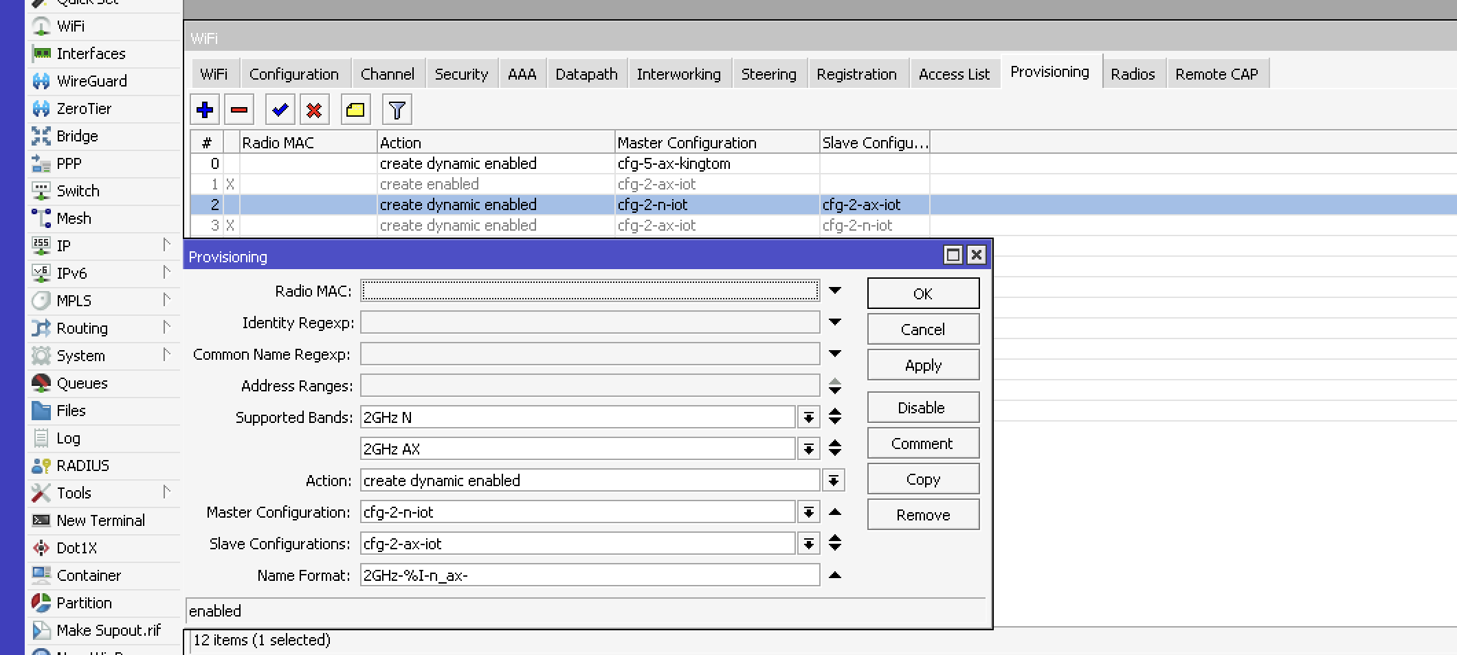

My situation is similar but i solved it like that:

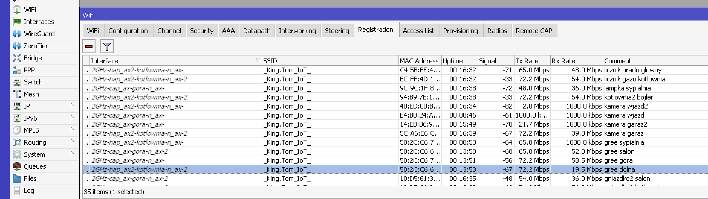

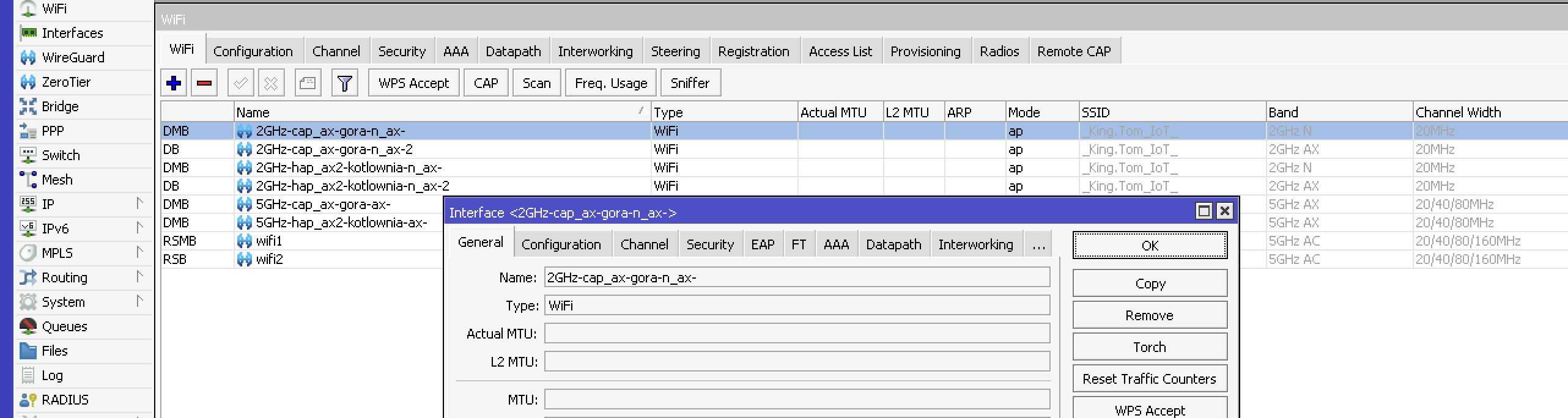

I have gree AC (4 appliances) they do not want to connect only to the caps with only ax network. Using my provisovision section I have a hybrid structure of 2.4 IoT network: main 2.4g network with N and slave working in AX standard.
My gree devices connect to my caps only when N standard is main and AX is slave. With AX first and only AX they do not connect. Strange is that they can connect to AX as you can see in my registration table. So probably when AX is only or AX is the first the devices can not see the network or something else.
