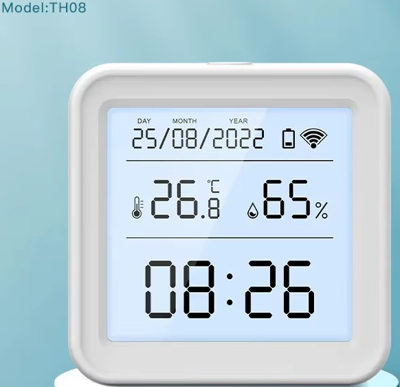

Same problem with connecting “Wifi Tuya Smart Temperature and Humidity Sensor” to WiFi MikroTik RB951Ui-2HnD RouterOS v7.16.2.
MikroTik RB951Ui-2HnD is an old device, only 2.4GHz, all home devices connect without problems, except “Tuya Smart WIFI Temperature Humidity Sensor”.

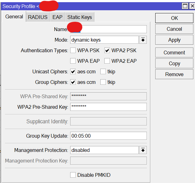

I tried to change the wireless interface modes and security profile settings can not solve the problem. :frowning:

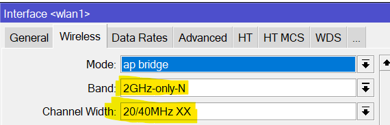

the devices started connecting to wifi when I set the following parameters:
Thanks, I solved the problem.
I made the settings as shown in the picture
It didn’t work, the sensor didn’t connect to WiFi. :confused:
