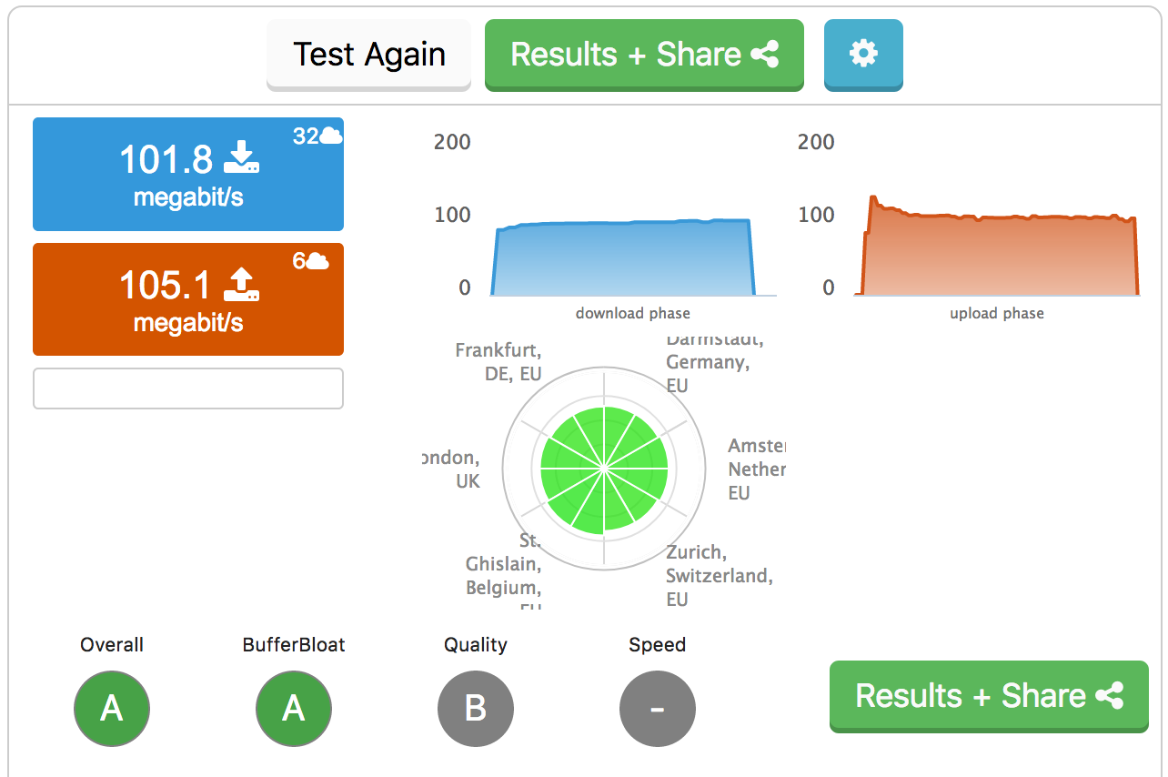

All the while I am testing with speedtest.net, on the website and its Mac app.
better test with http://www.dslreports.com/speedtest
gives you a better insight in what is happening
