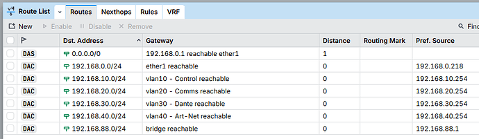

And it seems to have automatically made all of the routes I’d expect:
I’m trying to ping from a laptop attached to VLAN 30, which has been given IP address 192.168.30.102 by the DHCP server, to a laptop on VLAN 10, which case been given 192.168.10.100. I can successfully ping 192.168.10.100 from its own VLAN through the RouterOS tools, but not from the other VLANs. The traffic is also not showing in the firewall log.
