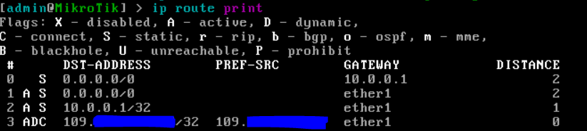

Post the output of:
/ip route print
dst-address is the same as pref-src and is public ip-address
Tried with only either rule 0, or rule 1, or both
The “no route to host” is normal, as that route (#0 in the screenshot) is “S” but not “A”.

Post again the /ip route print output.

here’s the output.

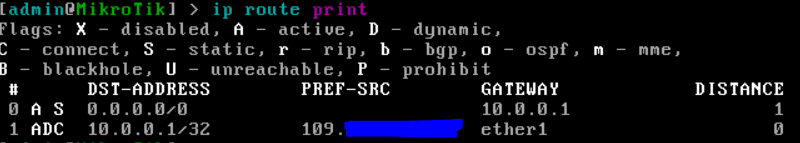

VPS hoster provided following settings for mikrotik:
/ip address add address=<IPv4>/32 network=<Gateway> broadcast=<IPv4> interface=ether1
/ip route add dst-address=0.0.0.0/0 gateway=<Gateway>
/ip dns set servers=1.1.1.1,8.8.8.8
Which appears to be mostly the same as I’ve set.
However it is working now!!!
Can someone explain the difference between my initial config and this?
Good. :slight_smile:
Your connection/route to 10.0.0.1/32 became ADC, the A is active (as before) but it is not anymore static, it is DC (Dynamic and Connected) and has a distance of 0 which means that the router automatically added it, and this AFAIK only happens if the DST-ADDRESS is in the same subnet as the IP address of the connected interface or however it knows somehow where to find it, I am guessing that the
part is somehow doing the latter
Look for “connected routes” here:
https://help.mikrotik.com/docs/display/ROS/IP+Routing
(of course there is nothing about this case).
I found an old reference here (from an official Mikrotik support staff)
http://forum.mikrotik.com/t/ros-on-kvm-on-hosted-server-issue-dedibox-online-net/54695/1
so maybe it is only the “network” that does the trick. :confused:
