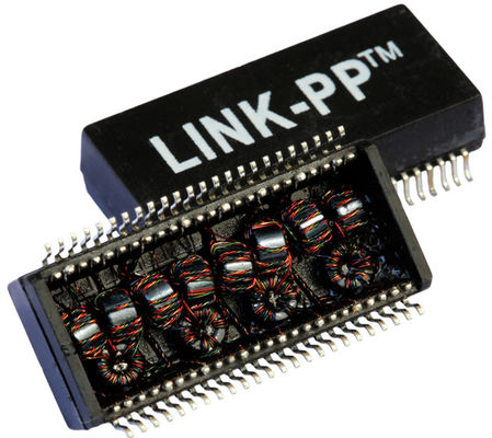

If none helps, an ohmmeter should show an “almost short circuit” between wires 1&2, 3&6, 4&5, and 7&8 - internally, the pairs are terminated at transformers that have almost zero resistance for DC:
If it doesn’t, there’s a plug/receptacle compatibility problem or an internal problem on the 493 (given the design, this would be inside the receptacle which seems to include these transformers). If these pairs “beep”, there may still be a soldering problem between the receptacle and the PCB.
