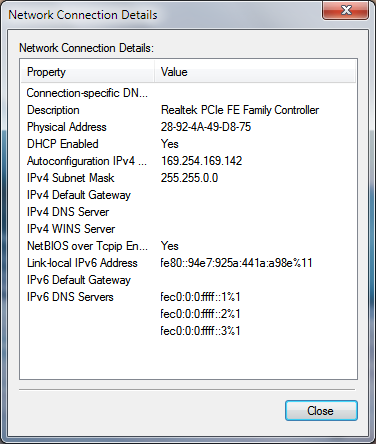

I did a rest configuration for my mikrotik router and remove the configuration script. But rightnow I only able to login using by the MAC address and I don’t any IP address from all the router port. How configure the setting that I can use default login IP address which is 192.168.88.1 and also I don’t wish to change any setting to default because I didn’t successfully setup my hotspot which this setting.
Also my PC didn’t get any IP address from the router while I’m using the cable.
