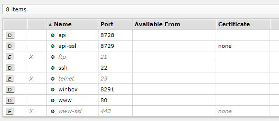

Winbox service is enabled:

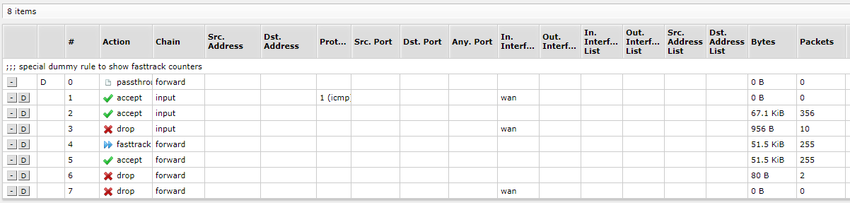

Firewall is set up correctly:
