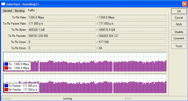

just FYI =)
looking forward to v5 with it’s multicore patches %)
