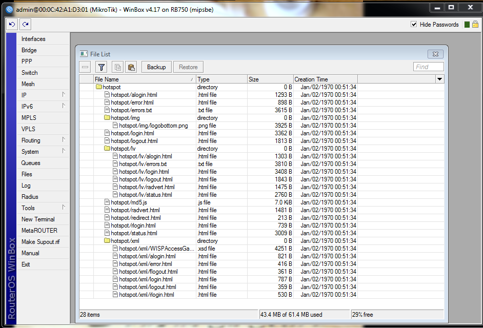

in files, is hotspot directory available ?

yes i checked it before and even i reset html in ip>hotspot several times but …
anyway i doubt about it(login web page in hospot directory)
because even in browser it tries to open login page and in action center i see this message that " additional log on is required"
but everything i do ,doesn’t work
see the picture i attached
