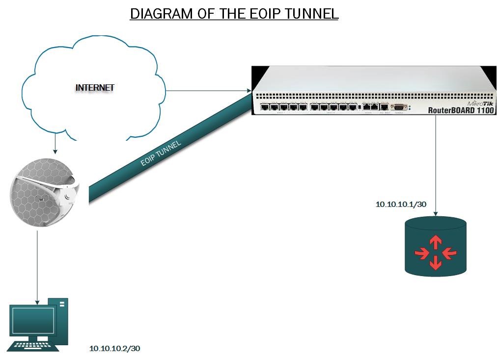

Please i have configured eoip over the internet to two mikrotik routers: LHG R and 1100 routers.
The tunnel is UP but the host machines connected are unable to ping each other.
Attached is the diagram.
Kindly assist
Hello Team,
Kindly assist
So on each router you have an eoip interface, a physical port, and a bridge that contains both?
I’m guessing there’s no entry in the arp tables?
You have to make sure that EoIP interface is bridged with ether1 on LHG and with interface connected to 10.10.10.1 on RB1100.
That’s obviously if you want to have them in the same broadcast domain.
Can you share your config?
if u haven’t bridge the LTE interface, then you must add a route of the LAN IP of LHG to the router with the gateway of LHG EoIP Tunnel.
