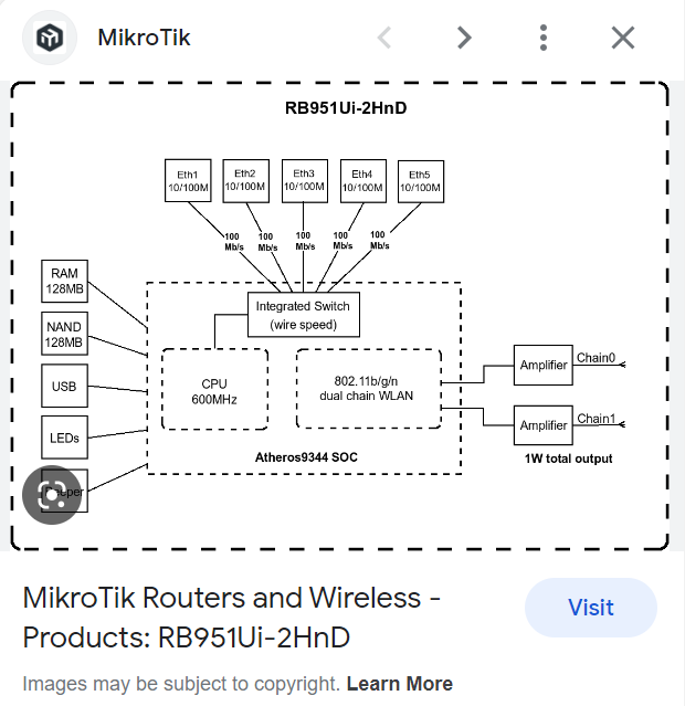

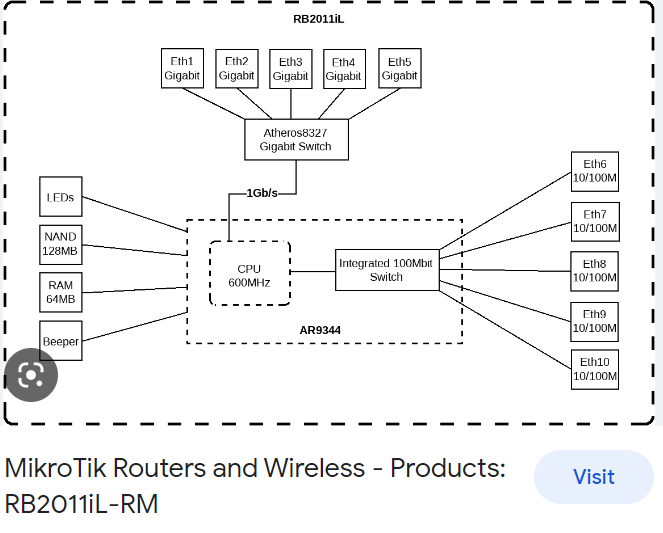

in my previous devices -(RB951ui)- its normal to ping another device that connected to another interface -(like if my PC connected to ether-2 with IP=192.168.20.100 and my access point connected to ether-3 with IP 192.168.30.100 i could access it from my PC)- but in my new RB2011iL-RM i couldnt do that even with the same config.
is this related to a different hardware ..?
i was looking to a hardware Plan for each of them and i couldnt find the big difference between them so anyone have any idea..?

Quite possible as different hardware require different configuration (and those two are quite different).
Have a look at post #3 and #5 in the Bad performance (slow) of RB2011UAS-2HnD topic, than continue in the Layer2 misconfiguration section of the documentation.
