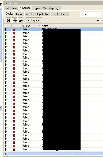

I tried upgrading by using “under the tree view => Devices => RouterOS” but almost all have red X status is “failed” is listed for almost all except for a few devices?
That red x means it’s not connected, right click say reconnect, then see that it changes to an check mark before upgrading, it just means that there is no winbox connection available from the Dude server.
No problem with connecting to devices with Winbox and when I tried “reconnect” I get red X and “failed”?
well, the issue is that the dude is not connected to the devices via the winbox port. When the device is connected u will see the ver at the right, if dude cant decide what system it is aka x86/misbe/mipsle then it cant know what software to push. if that makes sence, when u in the device can you see the routeros details come back?

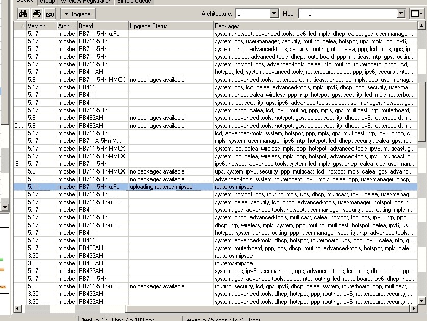

Found part of the problem, had disabled in most MT devices port 8728 (Ip > services > API 8728) now I have in (Devices > RouterOS) the details of each device but another issue is now when I try to upgrade Status says in most but not all “No Packages Availabe”
ok so you will see the difference as you go along, but for the problem that you have its because you running different packages,
so when you download the “full package” the single package then it will be better, once everything is standard it will go easier, you dont need all the different packages anymore.

I finally pin-pointed my issue and it was in the way i was manually upgrading each device and I would open the npk file and drag and drop contents into the device files and reboot but this did not have in System » Pacakages » routeros-mipsbe was not listed, so when I tried to update from Dude I got “no package available”, had to drag & drop the npk folder and not individual files into the the files of each device , rebooted and now I can upgrade with Dude.
