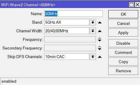

I’ve also just added a custom channel configuration like this:
Still running only 20MHz wide…
