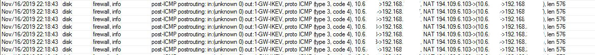

When testing the upload to a Speedtest server I get undecoded packets in Mangle.
Underneath a capture in Wireshark of a ICMP type 3-4 packet in Mangle during the upload test of Speedtest. These packets are generated on that exact moment.
I can log them in RAW and Filter but not look in the packets on that moment because Sniff is not possible there. The packets in Filter are also 576 bytes so they have to be the same ones.
Half of the PMUTD works and that is when downloading and it finds the right size for the packets. When uploading the PMTUD can’t be determined and I have to do that manually by setting a MTU size in Mangle for TCP packets.

EDIT: there is a much simpler way to get those packets decoded in Wireshark. While the packet with a wrong ethertype value is selected in the packet list, right-click it and choose Decode as… from the drop-down menu. Add a row to the table, and set its Field to Ethertype, Value to 0, and Current to IPv4.
So I disabled my MSS line again to generate the those packet. On upload they are generated and typing/browsing here in the Mikrotik forum new ones were coming in Wireshark. So I have now a second instance where those strange packets are generated.
My snifferline is catching postrouting/out packets, so I can’t put an IPSEC-in on it and it filters on ICMP and at the same time snifferline logs and source address it the local IKEv2 IP and the correct client computer running the speedtest or using the Mikrotik forum.
I made an error changing the sniffer line and activated the IPV4 Options field with option no record route by accident and the packets still came in. Changed the options to record route and the packets were not caught anymore.
