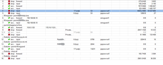

I have since disabled traffic to router on port 53 udp and tcp and the remote requets. The connections have returned to normal and the new rules are blocking approximately ˘1200 p/s. But the problem is that the internet connection is almost unusable. The ping to 8.8.8.8 takes 800ms+ and the overall network is very slow.

The attached configuration is just a testing configuration that I used on a hap2 to see if the network issue remains. This is the active FW configuration (note the open DNS connection there was before that i have disabled):

What is the cpu usage of your router right now? Have you tried creating a couple of raw (prerouting) firewall rules to drop incoming requests on tcp/udp port 53 so that your router isn’t processing every request?

@tin9 You can create filter rule to add IP which connecting to DNS port into address list for blocking and create raw filter rule that drops all packets in prerouting chain for IPs in that address list.
