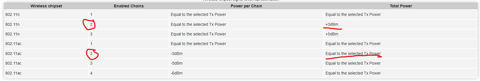

802.11n wireless chipsets represent power per chain and the 802.11ac wireless chipsets represent the total power, for reference see the table below:
The device has 2 antennas and 2 chains enabled
How to correctly understand the table below? And what power of the transmitter amplifier should I set so that the 5 GHz range is a priority? Or it’s enough to just underestimate it by 10 units, as I suggest above. I am not a radio frequency specialist, but I want to figure it out and understand the principle. Thank you.
