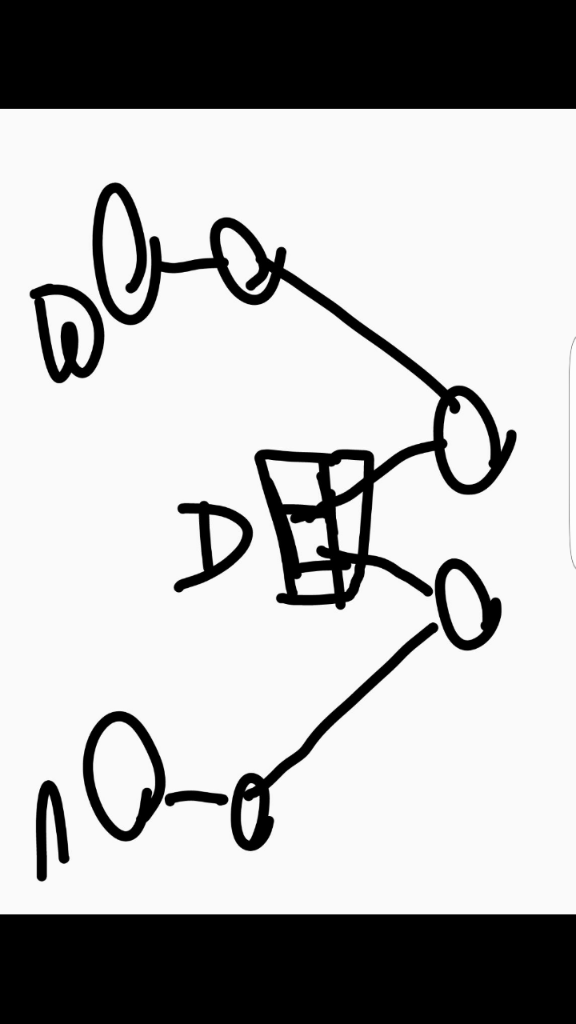

I’m actually not clear on what you are trying to do, either you are:
a) trying to incorporate your switch between two MPLS LDP routers so that it can provide routing for tunnels on the back end, of which some could be VPLS (but then you would need no ‘VPLS’ configuration on such a switch)
or
b) terminating a VPLS tunnel on router A and terminating another VPLS tunnel on router B, and interconnecting the layer2 domains with a switch in between going from one VPLS tunnel to another one for purposes unknown, and both of these tunnels terminate somewhere else that you aren’t showing us for reasons unknown.
Your original diagram which said ‘MPLS ↔ switch <—> MPLS’ in picture form was essentially useless in understanding what you want or the way you are trying to set things up.
