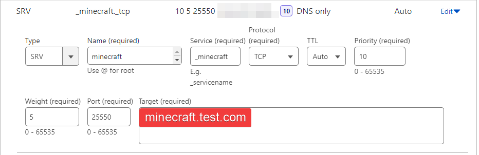

I am connecting through subdomain minecraft.test.com. This is using a CNAME rule to my dynamic dns service, and a srv record to point to the correct port. I can ping my DDNS and get the correct public IP.
CNAME Record
SRV Record

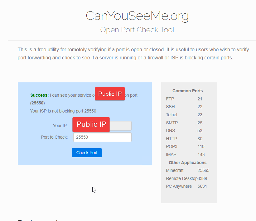

It says I can reach the port from my server device

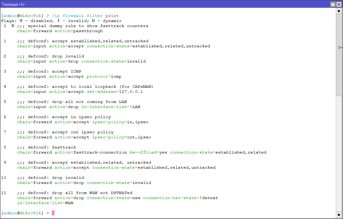

Firewall Rules

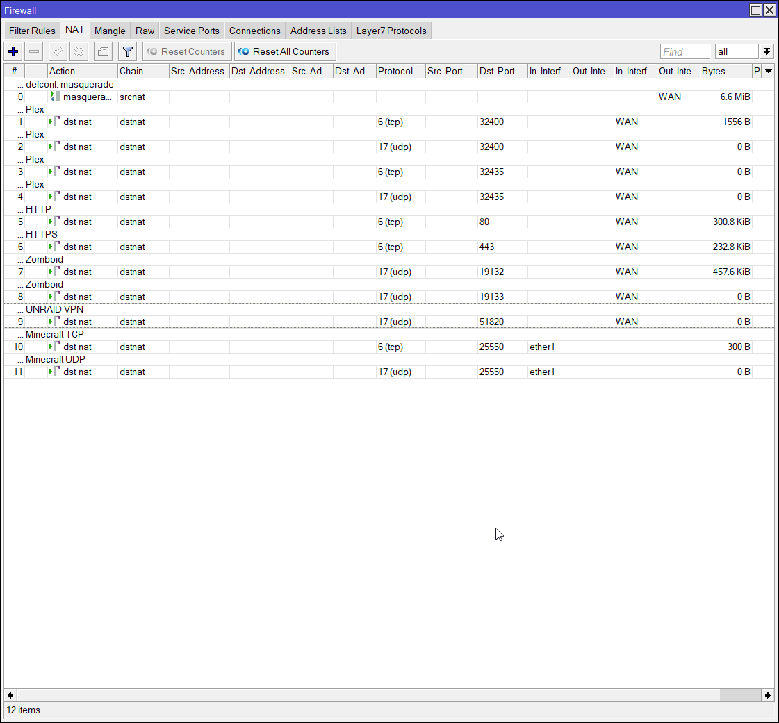

NAT Rules - I see that my other rules are using “In. Interface List” instead of “In. Interface”

Well…try to refer to Interface address lists like the other (apparently working ones) ?? Why do you select “ether1” and not “WAN” ? You tried and it doesn’t work ?
You reference “ether1” for these Minecraft rules but that might be wrong. If you are using PPPoE for example to your ISP this probably will not work. This needs to be correct to start with.

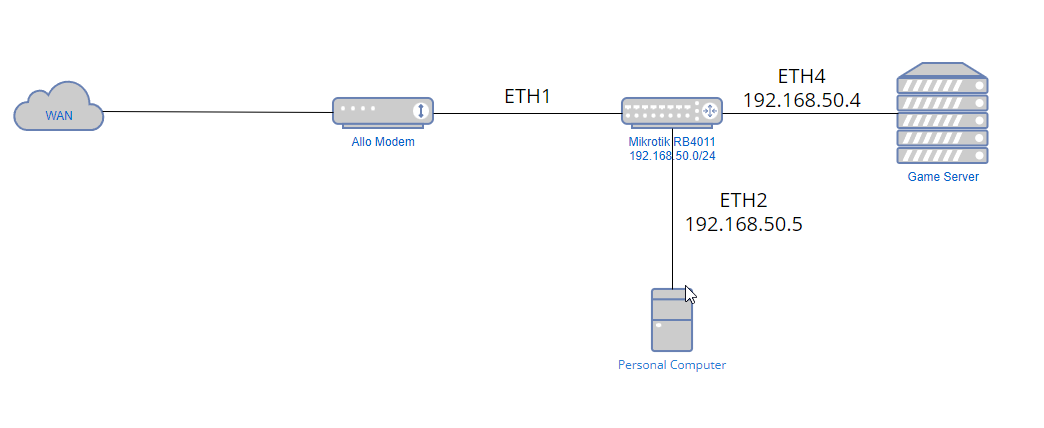

You want to start with making a small drawing what you have constructed. What is “a separate device” ? Router ? Switch ?

  1. I tried switching the interface over to WAN and still nothing. Although it says the port is open on my Server through public IP.
  2. ETH1 is where my Mikrotik Router is connecting to my ISP. ETH4 is where my Server connects to my Router, see the diagram below I created
