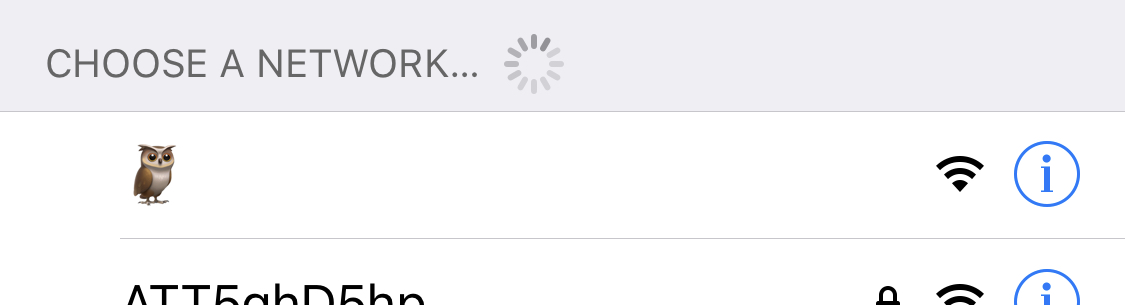

Managed to get it working through the API, this seems like the only way to do it for anyone else interested in it.
Quick test says it works from CLI, if you enter utf-8 bytes like this:
ssid="\C4\9B\C5\A1\C4\8D\C5\99\C5\BE\C3\BD\C3\A1\C3\AD\C3\A9"
In WinBox it looks like typical broken utf-8:
But other devices (well, so far only one old Android phone I had available) see it as correct “ěščřžýáíé”.

Nice, didn’t realise escape sequences worked in the CLI. Much easier!
Made a quick script for encoding UTF-8 as raw character sequences for use in the command line.
https://r-1.ch/mikrotik-unicode-ssid-generator.php
