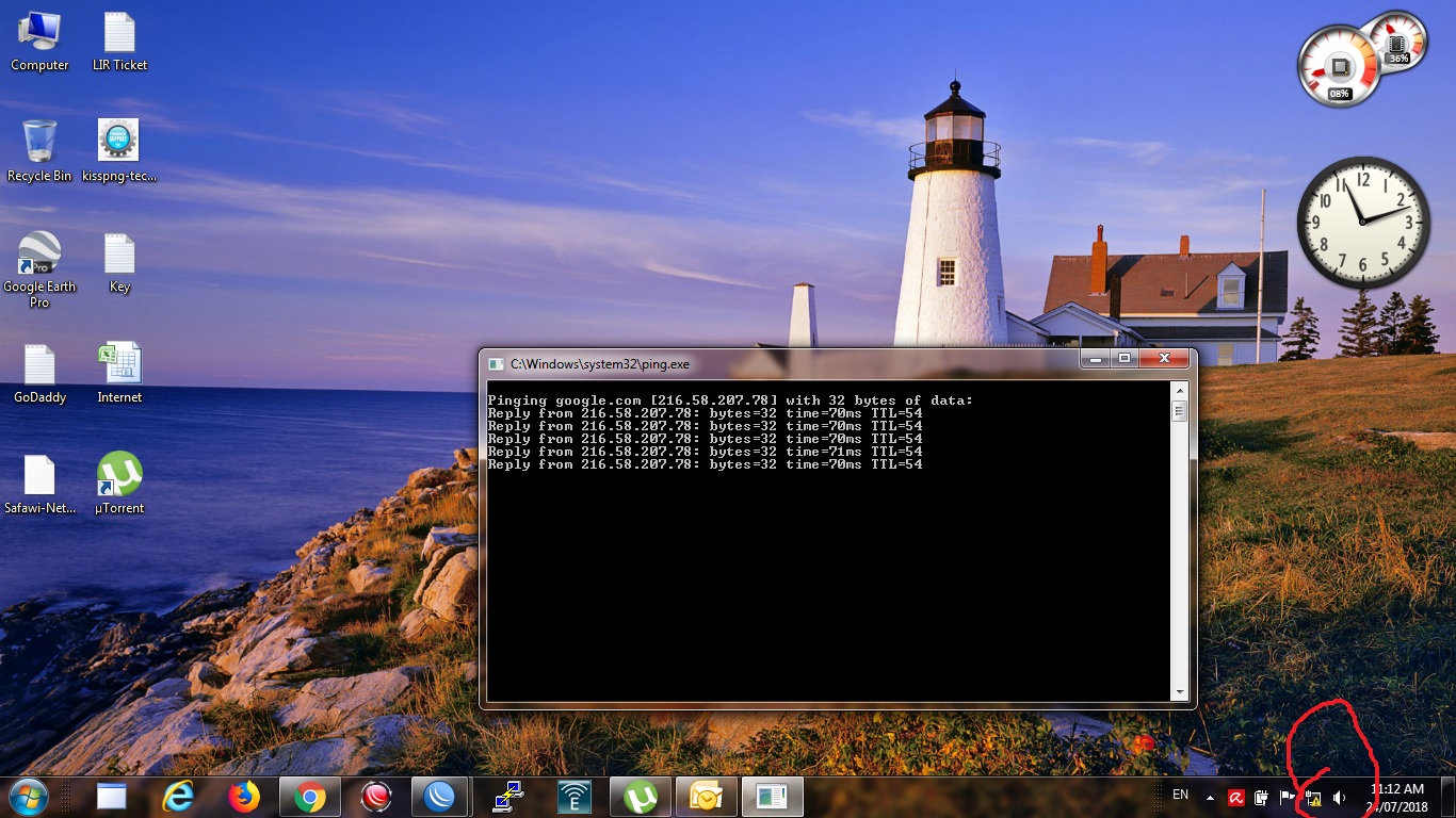

PPPOE 1016 the problem is whither the client connected pppoe or static ip it always give alarm that unidentified network but the internet is working

when i put the proxy nat before src nat it will give me the unidentified network error when i disable it it will disappear
now im trying to put the dst under im not getting the error but when a client connect to the network he get just like hotspot (additional option required ) and its pointing to open browser yet the browser
