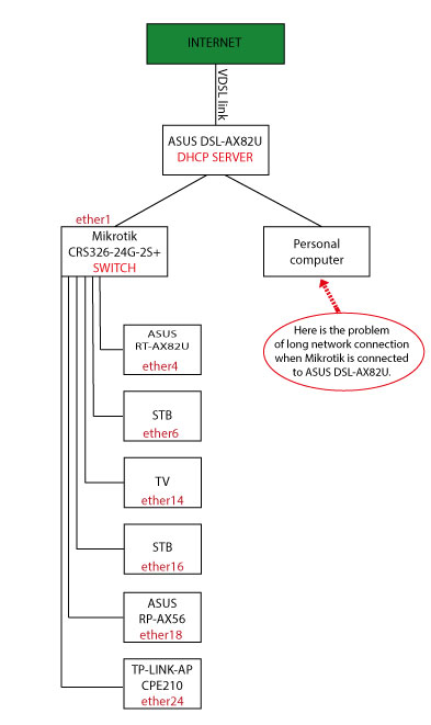

I have an ASUS DSL-AX82U as the main router, a PC (port1) and a Mikrotik crs326-24G-2S+ (port4) connected to it. Mikrotik is set as a switch (bridge).
  • If Mikrotik is not connected to the ASUS DSL-AX82U router, the PC will connect to the network immediately after loading the desktop.
  • However, if a Mikrotik is also connected to the ASUS DSL-AX82U router, it takes 30 seconds to connect the PC to the network.
  • If I connect the PC via Mikrotik, even in this case it connects to the network immediately after loading the desktop.
What could be the problem?
Sorry for my english, I used google translate.
Could you provide any diagram and the configuration of the CRS?
I am attaching the diagram and configuration. Somehow I did not make a big intervention in the setting. Unfortunately, I’m not that knowledgeable, I set it up according to the instructions on the Internet.
The problem is even if there are no devices connected to the Mikrotik.
