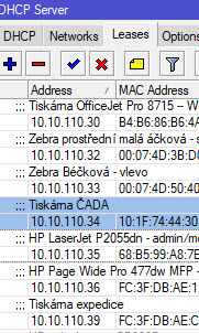

You can see in attached pictures.
IP 10.10.110.31

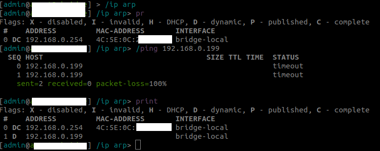

That happens when your router tries to reach that address but no device is answering (ARP)
You can easily try this out:
  • Check /ip arp
  • Try to ping an address which is not in use
  • Check /ip arp again
