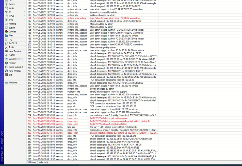

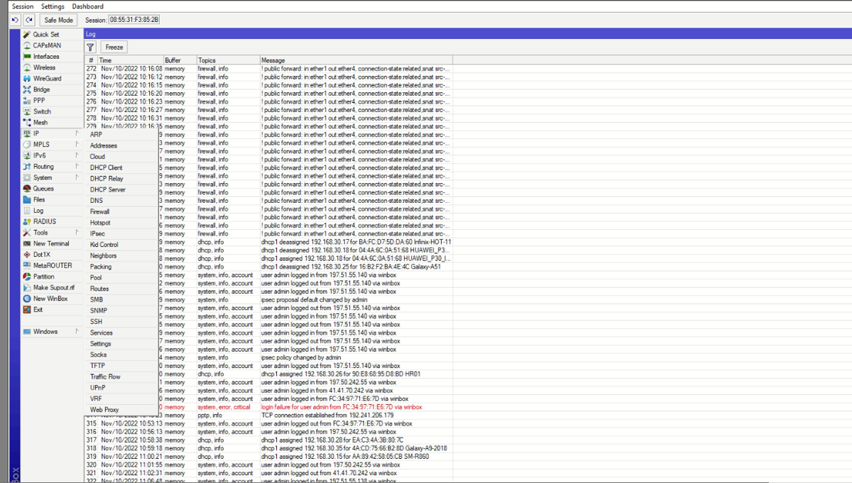

first when i enter to my mikrotik via winbox i get this error message -(see the figure-1 below the red line: login failuer for user admin from 172.33.0.2)- yet i enter normaly without any password error or any other delay
also i get this ipsec error message -(see the figure-2 below also the red line error in log )-. however, i didnt setup any ipsec tunnel on my mikrotik. does this refer to any attemp to attack my machines..?

figure-2 is the first picture
figure-1 is the second picture
When you show is such a screendump of an entire log window you can at least tell us the line numbers of the messages you are worried about!
When you do not use IPsec and you still get these messages (which are portscans to find who uses IPsec to use for later attack) your firewall is configured wrong.

Depends on your device. What router model do you have?
In some devices there is a default firewall which protects you. In other devices (CCR, CHR, RB1100) there is no default firewall and you have to make one yourself.
