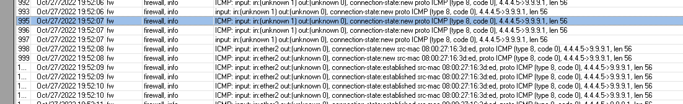

i did a few more tests and it seems to be related to mpls. With v7 packets to the loopback IP of an mpls enabled router is not bound to the correct input interface?!
I setup a lab according to https://wiki.mikrotik.com/wiki/Manual:MPLSVPLS with chr inside virtual box.
First with 6.49.7 which was working then 7.6 which was not working and after that i upgraded 6.49.7 to 7.6 and it also stopped working.
Until Log Entry 997 MPLS was enabled and after that i disabled it:
But i still don’t know if this is a bug or by design…
