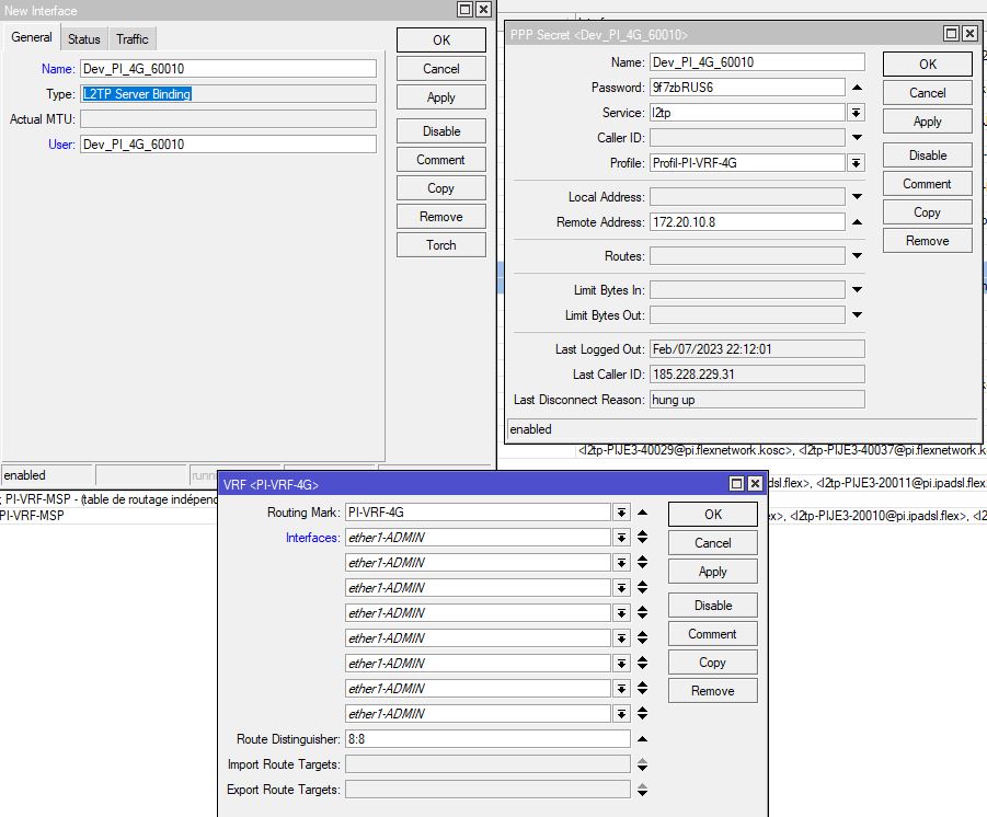

so according to your technique I have to put the same name that I use of a secret PPP in a new L2TP server binding interface and then add this L2TP server binding interface in the VRF?
If I understood correctly using this technique no longer need to use the up and down script in the profile?
I attached a screenshot
correct , no need script.
As long as u put statically (v6) with only-one=yes, will work fine
