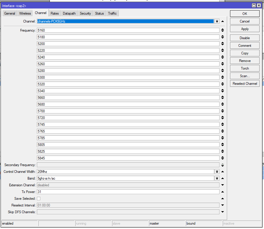

I have Mikrotik Omnitik POE 5 ac,
the documentation says it supports 31 dBm,
I’m setting the Tx power to 31 dBm, but the maximum power I get is 22 dBm.
Please advise, how to unlock the full power?
The screenshots are below:

6MBit/s transmit-dBm: 31 or 54MBit/s transmit-dBm: 27 - is exactly what I need, but it only provides me 22 dBm max, which is not enough. The AP is in the rural area, no one around could be affected. I did this before with another vendor, and it works for years, no issues with the law.
@TomjNorthIdaho, In the Interface List section I can see the following:
managed by CAPsMAN
channel 8525/20/ac(22dBm), SSID CKP, local forwarding.
even though I configured it for 31 dBm.
it works, but only for like 15-20 meters, and this is an outdoors device, I need it to cover 40-50 meters outdoors, which I think is possible, if I could unlock the dBms to the full power.
