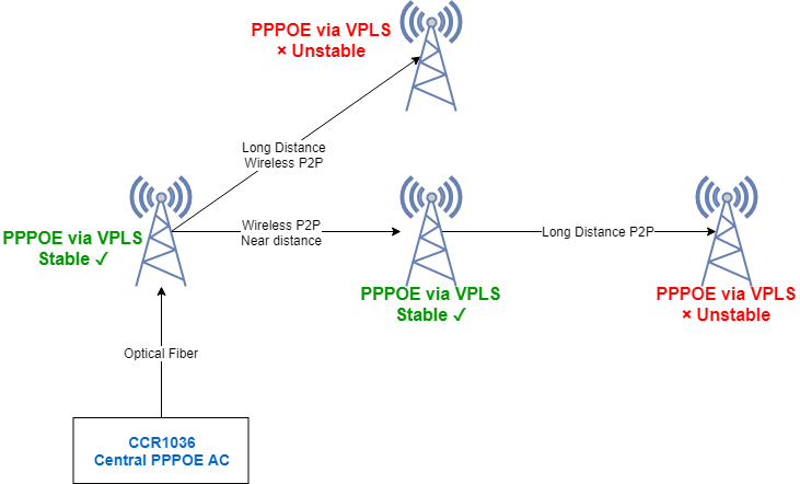

We’ve deployed our WISP with a central PPPOE via VPLS tunnels .
VPLS works well and we have full 1500 bytes trough it , each tunnel have one PPPOE server .
But the problem is VPLS tunnels disconnect for 60 seconds (minimum) for any packet lost on remote sites, so all of that site’s pppoe users will disconnect.
The long distance remotes sites connected via Point to point wireless got packet lost 10 times in 24 hour and each time VPLS tunnels will down for long time .
If I change the VPLS to EOIP , pppoe users connected trough it just got some packet lost (very stable than VPLS) , but VPLS have a better performance and lower CPU usage.
Is there anyway to reduce the down time or prevent from disconnecting ? (other than fix the long distance wireless links :slight_smile:
Example diagram :

Each Site connect with one PPPoE server that come from Central CCR via a VPLS tunnel, YES! all users of that site will terminate when VPLS disconnect.

All of network is routed on each site and just wireless links are in P2P mode / Bridge.
each site have a /29 addresses for self or for next site , for example :
Router [IP x.x.x.1/29] ===> AP device (bridged) [IP x.x.x.2/29] ===> CPE device (bridged) [IP x.x.x.3/29] ===> Router [IP x.x.x.4/29] .
