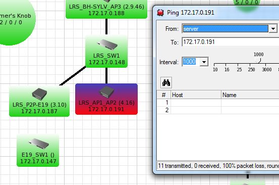

Anyways, check this out… The Dude reports this unit down for hours…
Try to ping from the Dude PC, not from a router. If it’s available from one place, doesn’t mean it’s available from another.

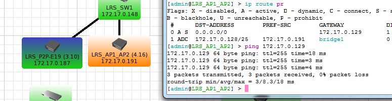

Yup, that was the first image in my post. Ping from The Dude goes nowhere. I also can’t open a terminal or log in via Winbox. The MT unit is also non-responsive from other machines at the core.

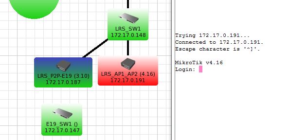

So, the second screenshot, I used the remote connection tool to telnet in from another unit, and pinged back to the router at the core. At this time, monitoring came back alive and all is good.
This unit is 3 sites away from The Dude… every link is a wds bridge between Cisco switches. I’m thinking that the forwarding database is getting stale somewhere in the middle. As a stop-gap, I created a job to ping the gateway periodically. So far, the phantom flapping is gone.
