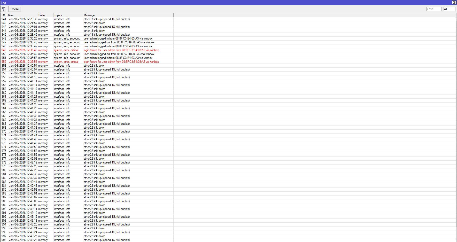

Up/Down link status in CRS345 switch

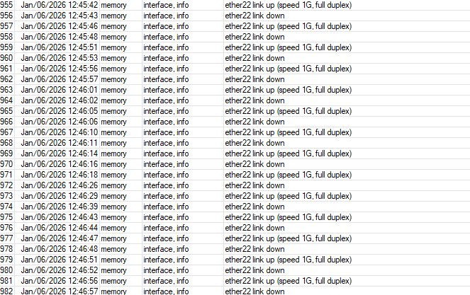

i keep seeing ports go up and down status, please not its not only this port 22, randomly change every now and then

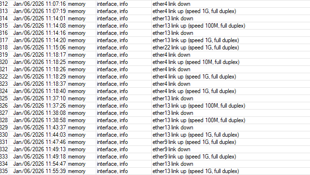

At the last picture it could be spotted that between etch13 down and up there are 7, 4 seconds and then 50, 26, 52 ... why so long? On the other hand there is a "double/half" pattern 7 -> 2 x 4, 50 -> 2 x 26 -> 52. For eth4 pattarn is different but it's also not off/on but off ... wait, wait ... on
