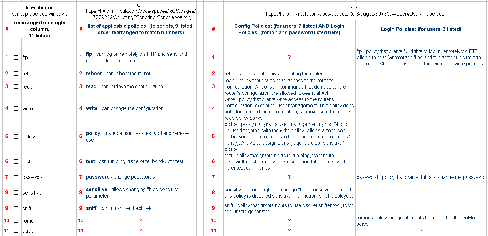

Coincidentally I am trying to put together a "cheatsheet" for policies, at the moment nothing of practical use, but I have assembled this "general scheme":
This said, what I personally do is to give to a script all permissions (minus the obvioously unrelated ones) then remove one by one until it stops running, and then re-add the last removed one, it is a 4-5, maybe 6 steps procedure and definitely far from elegant, but it is not that bad after all.
