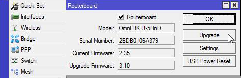

First, update the bios.
Go to “system” “routerboard” click on “upgrade”
